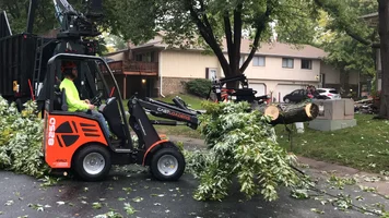

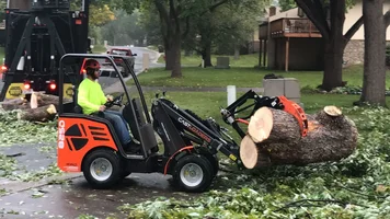

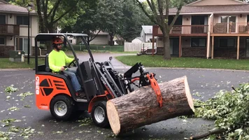

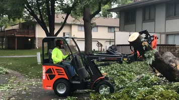

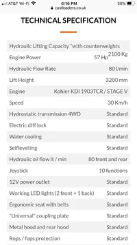

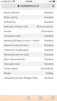

Coming July 2019... The latest addition to the the CAST Loader line... NEW MODEL CAST 57T
