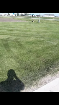

I never seen anyone around here using those wheeled mini skid units. I always thought they would be insufficient. Are they much better on lawns than tracks?
I've only used two mini skids. A rental, a Toro 427tx (I think) and my vermeer s600. The Toro was a walk behind track mini, it was harder on the grass and had a lower tipping point. Not exactly an even comparison, but I've been very happy with my vermeer.
One thing that I have noticed is most mini skids on wheels have large tires, mine has fairly low profile tires that are foam filled. I suspect a tall air filled tire would bounce much more.
Here is a picture of a test 180° turn that I did at the dealer when I bought it. However if you do get it in mud, it will certainly leave ruts.
