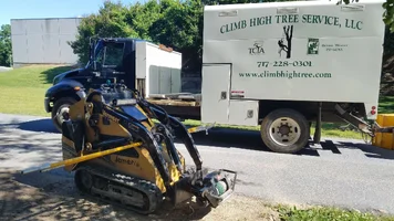

I put my warn 10,000 lbs winch on my mini quite often for pulling over trees, especially in a wooded area. Most times it does not slide, but if the ground is soft or the tree has a heavy back lean i will just strap the mini to another tree etc
It it just a receiver hitch plate for the mini. I used go have a small winch I designed to go in the bmg, but I prefer this method.
Ps it is especially nice with a wireless remote for the winch

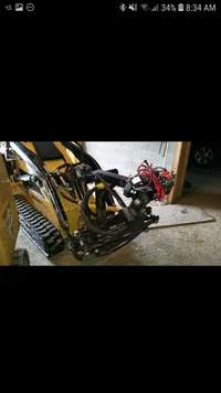

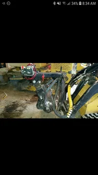

I had to dig for pictures of the how I mounted an electric 3000 lbs winch to the bmg, end up doing screen shots from my Facebook account. This style works, but I feel it puts more strain on the mini/hydraulics...though I usually had the bmg strapped to the mini to help that.
Screenshot_20180902-083442_Facebook.jpg Screenshot_20180902-083447_Facebook.jpg

I really like your set up with the truck. Do you use the branch manager rake? do you think it could be modded to fit on a Vermeer grapple?
climbhightree
Well-Known Member
Lebanon, Pa USA
I honestly don't use the rake much, but I am glad I bought it. It mostly gets used for snow on my driveways. Every once and a while I'll use it for tree work (parking lot clean up, crispy tree flop, brush piles).
Uou could probably make it work, but font ghink it would be extremely easy. Vermeer grapple mounts different and the grapple tongs are a lot bigger.
