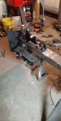

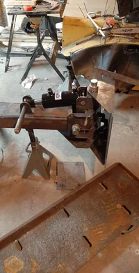

Hi guys I'm currently building a stump grinder attachment to go on just about anything and was looking for feedback on possibly producing them for sale.. I went with the direct drive engine driven attachment with 29 & 35hp vanguard engines.. I prefer that over hydraulics since stump grinding is all about horsepower and you loose to much with a pump and motor setup.. mine has vertical and horizontal motion unlike other brands so it is more universal and doesn't beat on your bucket tilt cylinder on the machine its attached to.. it has it's own pump and hydraulics with remote controls so you can still run it while standing away from the mini skid, ect. For them tricky tight space jobs like in sidewalks.. I'm thinking it would retail at $10,000 as of now.. I'm about 60% finished with it and will be torture testing it and put it in a couple local rental fleets to give it the idiot proof testing.. I'm building plates that will work with full size skids, bobcat MTs, avants, and toro dingos, as well as a trailer for tow behind and possibly a self propelled chassis by mid summer.. if there is any interest I'd appreciate input thanks

Interesting looking machine; I would like to see it with an engine on first before I can put together any opinions. I don’t see so far how it won’t hang on the bucket tilt cylinder like a regular grinder, since it still mounts on the quick attach. Nor do I see how the price can be so low, considering that a hydraulic powered attachment costs that much, and this one has its own engine and hydraulics.
