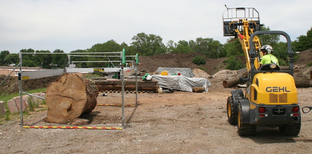

I bought a Lucas mill this year to take advantage of some of the nice hardwood trees we cut down. I started with a chainsaw mill but its way too much work to be profitable. The lucas mill allows us to make slabs as well as dimensional lumber.
Nice setup, been toying with the idea of a lucasmill but I rarely run across logs that are big enough to slow down my 090 setup. I also like the low setup time with the alaskan mill.. and with a beam machine I can whip out dimensional lumber as well, just a bit slower.
What's the throat on that model mill?
