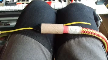

Another thing I've experimented with is the cones from fireworks. Just cut off the top enough to get your throwline through, then attach your line and pull it into the cone.
I have a pointier cone that works without the cardboard, but I don’t have a picture.
