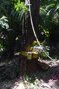

lowering device !! Don't go cheap pay that extra buck it's worth it.. we have Hobbs lowering and lifting device, we would be lost w/out it.. we have a large rain forest at work and all our tree work has to be lower down piece by piece, no way to get a crane in or our boom truck , so all is done w/ this bad boy.. good luck shopping....
