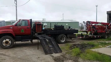

I like the bi gold ramps for the mini. It has always been my plan to do that with my truck...both sides. I just haven't found anyone yo fab it up for me yet.
The ramps work pretty well. They're a little steep but we get by. We had to cut out a small piece on the platform on the mini to get it to fold up. It would plow a good chunk of dirt or gravel if not on pavement. Ramps on both sides would be tough due to the amount of space they take up. We have to put the BMG in the back of the truck with only one ramp. We should've put it on the passenger side and park across driveway to unload there instead of in the street. Few bugs but far better than putting it on a trailer
