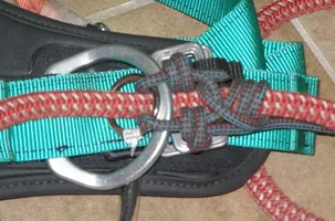

The hip drings on TF are medium sized with a 'diamond' end to force the attachments to the apex. My favorite lanyard adjustment configuration is to tie the cord directly to the dring and use the dring as the slack tender. Occasionally the hitch would invert and pull through the dring.

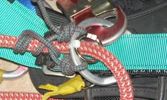

I bought two rings for fifty cents each at the hardware store to use as slack tenders. In this pic I used a nylon ziptie to hold the ring. This works OK but not great. In time I can see that the tab on the ziptie would snag or pick.
This configuration seems to work a bit better. The metal ring is captured by the scaffold hitches of the hitch. Since the ring is held by two tensioned cords it rotates less and keeps the ring fair to the lanyard rope. This seems like the way to go.
