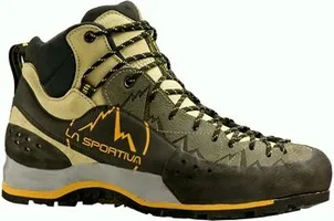

I like the look of these boots but haven't tried them. Ganda guide.

i just got a pair of the ganda guides and i absolutely love them. they are the most comfortable boot that i have worn and they work extremely well for footlocking and pruning, however, i have not used them with spikes but can imagine that they would not be real great for that. we dont do alot of removals here so they are perfect for me.

I would really like to know how these hold up. I have had my eye on these boots for a while but I can't bring myself to fork over 235 bones for these. I have a pair of low-cut 5.10 approach shoes that I rec-climb in from time to time. I love the way they climb. The smallest knot, or swell in the trunk is sufficient for a foot hold, but they don't stand up to abuse in trees like they do on rock. I have only climbed trees in them a couple of times and they are already showing wear.
The boots mentioned in the original post are beefier boots but they are made for mountaineering and should be pretty good at edging on knots and such as well. They are just going to be pretty stiff which isn't a bad thing once you are used to it.
I think we are all looking for the perfect boot. My ideal boot would be like these Ganda guides, but all one piece of leather, no webbing lace loops and more stiching than glue. They would also last at least a year with a price tag of 200 or more. Any sugguestions?

They're just so damned hideous. If they were all brown and laced to the toe I'd be all over 'em. My grandma had polio and wore some funky black boot-type shoes. That's what they remind me of.

I'm ordering a pair of Ganda Guides tomorrow. It's really hard to get a good fitting shoe without lacing going into the toe box. That's what I really like about these shoes, plus I have a ProDeal with them and can get them for a hair shy of 150.00. You might see if you can get the same deal as well. Go to OutdoorProlink and apply for a prodeal. I'll report back later once I try them out for a few weeks.
