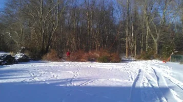

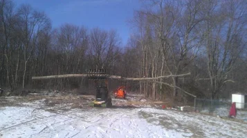

in rain the green tracks have no problem. Ive driven into the bank edges of lakes to skid trees out. without a problem. A tired skid loader would of gotten stuck and sank to china. the surface area of a track loader is much greate,r smooth or rugged, has never been an issue for us except in the snow.
On a hill in the snow, yes it can be a problem, flat no problem. Here is a couple pics of a lot clearing job we did with an asv rc50 with green tracks in the SNOW a few weeks ago

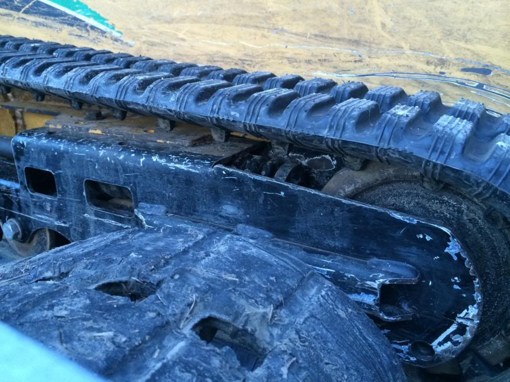

Maybe just keep a worn out pair of tracks around if you have that picky customer. This is how worn out we let them go before we replace them. First job with the new tracks actually made me miss the worn out ones a bit. The worn tracks are a little more forgiving.
Just put a set on a boxer and they are very unforgiving compared to the old ones. Had a belt break and stretched out. Summit Supply on ebay has a good selection
