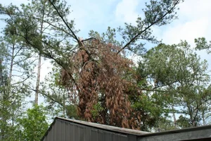

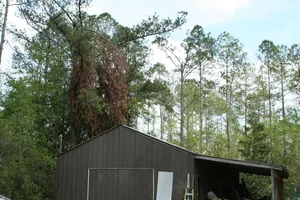

Here are picts from a tree we removed over a warehouse.
Graeme McMahon's thread on "Folding Tree" made me think of these pictures...this tree was folded before we got to it.

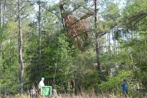

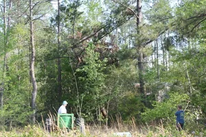

We considered a high line to rope out the limbs but one of the two properly positioned rigging trees had the top "drop crotched" out of it by a Katrina twister so we did otherwise.

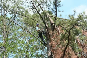

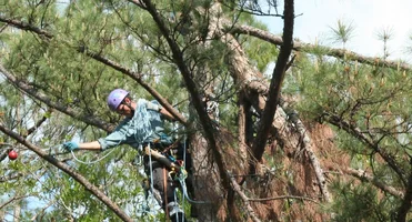

The top looked to still be firmly attached. I Big Shotted a line and ascended the safe side of the tree. Once there, I did a quick rope tie to secure the top while I hauled up chain.
The chain and rope were to (1) secure the top and protect the faller and (2) to be sure the top stayed attached and travelled with the tree when it was felled.

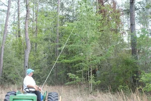

I am using the wooden throwball (like a croquet ball) to send the pull line out over nearby trees to the tractor.
