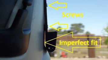

And like David has pointed out, I can see future problems with the muff adapters. The pre-drilled holes, for the metal mounts, are 1mm-2mm drilled too close to the edging of the helmet. This creates an unperfect fit and caused one of my tiny screws to strip. (Thankfully, an extra screw came with it).

This is what I mean abou the holes being too close to the edging...
new mounts are coming by end of the month, see my previous post to get a feel for what they look like and how they mount.
