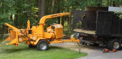

Yah, that "little" hole was a result of a bad weld job. I told my guy (whom I no longer use, imagine that) to leave NO SEAMS in the welds, cover them over, whatever you have to do. First day after the weld was done (incorrectly, obv) a log caught the seam and twisted the metal backward. Lovely!
Now I have a good welder, but I still haven't fixed the hole, it's just one of those things on the reaaaaaly long list of things to fix that'll probably be put off indefinitely. You can't see it in the photo, but there is heavy-duty steel wire behind the hole, which is in fine shape and keeps stuff from falling through.
Chips don't fly out back there anyway, and once the F350 is that full, well, i'ts probably time to roll, right?
You're comment on the "nice looking" part is echoed by a lot of customers. It's the little details, like the chromed wheels, that gets people's attention. Including mine, I guess.
