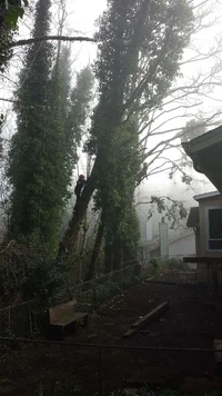

Here's a picture of a Red Alder stand engulfed in English Ivy that we were cleaning out a couple of weeks ago. Its a big problem here. Oh, make sure you bid it on a day rate basis and the customer understands the pricing and how little may actually get done because it can be very time consuming, too.

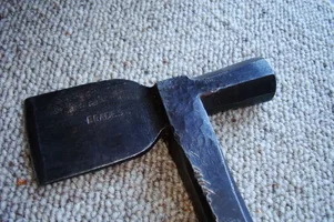

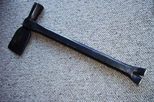

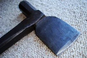

Thanks, good post, that's the sort of problems we suffer ref. the picture, later I will take a picture of one of my tools, it has everything needed to remove the ivy, just heavy, so I think there is an opportunity here for someone.
This is my one tool, its an old thing, but it would good if there is something modern and light out there, the axe head is handy for cutting on the stem, hammer is great for flattening and bashing, crow-bar is also a bonus.
Its just bit to heavy to have around you up a tree.

This piece looks like it has pulled off the torturer's wall from some London dungeon. My, Tuttle, the friends you must keep! I never would bring an axe into the tree to "hack" at ivy on a stem. Too dangerous and too much damage to the host tree. Need precision cutting of ivy vines with a handsaw. A claw hammer will provide the pry power you need--with safety.
