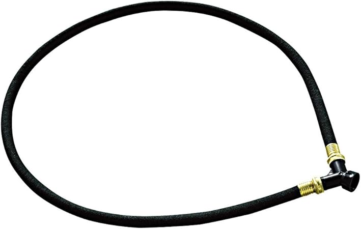

Soaker hoses are granular rubber bits fused into hoses, but have many, many small pores, to allow the slow distribution of water.
Used in gardens, new lawns, tree transplants, etc.
Just regulate the water supply: timer, pressure, etc.
Many, many different suppliers,
Suggest covering the soaker hose w/ mulch, straw, etc.
Soaker hose, obviously, can be cut into sections w/ added M & F fittings.
Depending on required water flow quantity, the supply hose could be cheap ~1/2".
Emitters allow you to precisely calibrate the amount of water going to the tree and are far and away a superior method of irrigating planted nursery stock. Many systems are barbed, so you can pull the supply line to site where the tree will go.. barb in however many emitters you need to give the number of gallons you want on the root ball in just a few seconds, and keep unrolling supply line to the next planting site. Determine how many gallons you want on the root ball, and then a combination of run time and number of emitters to provide that quantity. A battery powered valve on the hose bib will let you irrigate a precise amount, multiple times per day, and will allow drainage and gas exchange in between irrigation cycles.
I was thinking like this...decide whether it is easier/cheaper to buy one long one and make your own looks or buy loops:
