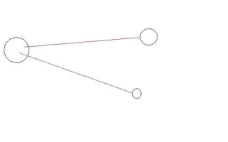

Any chance of using multiple trees and multiple guys? Just using 1 guy rope is not recommended. One 3/4" Stable braid is no where near enough strength to hold a red oak of that size (62 pounds per cbic foot green, plus the weight of the foliage). Not knowing enough about the surroundings, I try to spread the weight using multiple trees and angles. At the minimum a 'V rig' should be used.
See attachment. Top view.
