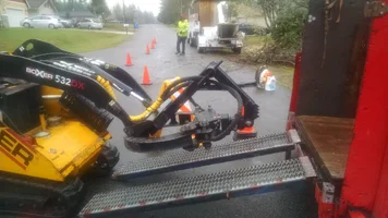

so a question about attachments in general. When I first got the grapple I had a hard time getting one of the couplers connected, I assumed Branch Manager tested the grapple and unhooked it under pressure. I've since swapped the grapple with the bucket and then went to put the grapple back on and fought with the connector again. Any tips? it is the female connector from the grapple to the male on the miniskid. all the parts have been cleaned, and moving well
Always release pressure on the hydraulic lines. Its brand new, and may be stiff.
Get all the pressure off the cylinders by having the grapple standing up on the tines, midway open, so its sorta resting on the frame.
Mine couplers gave me fits a couple times. Once, I cracked the line open at the cylinder to get the pressure off, as I had squeezed a log to "park" it. I squeezed hard, and the pressure of the bark resisting, seemingly put a bunch of pressure on the valve.
IDK if there is a bit of a wear-in time on couplers, or not. Mine were tricky a couple times, at first, coupled with Operator Error.
On MY vintage of BMG (IDK how many versions have been made), there is ONE (maybe one and a half) sweets spots where I get very positive grab on the spiked heel plate without interfering with the LOADER ARMS or grease fittings.
If a grease fitting's tapped-hole strips out, you can weld a 1/4" fine thread nut (IIRC) over the hole. Then screw a grease fitting/ zerk into that.
Always release pressure from grapple before disconnecting, and release pressure from machine before trying to connect.
Trick: if a coupler is fighting you have someone operate aux valve on machine (not running) back and forth while you push coupler.
I assume by releasing pressure you mean to operate the aux control a couple of times with the machine off? I did think ahead this last time and tried that before disconnecting. I ran into the same trouble where it took 4-5 attempts to make the connection with fluid leaking out on each unsuccessful attempt between the female on the grapple to the Male on the mini. The grapple male onto the mini's female goes together with no trouble each time.
Never have machine on when operating aux valve to release pressure from attachment. Same when hooking up attachment have machine off and operate aux valve before attempting to connect
Could be because of how you are storing Grapple, if it pushes down on ground (closing grapple) with it disconnected it will cause pressure on one hose ( on yours in assuming that's the female). So always either close Grapple completely or open fully then set on ground before depressurization of attachment and disconnect
Thanks. I'll give that a try
