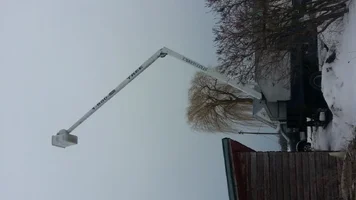

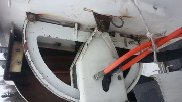

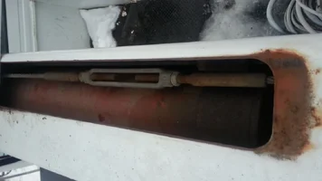

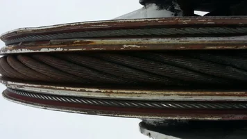

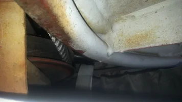

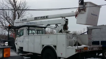

I have a 2002 Freightliner with the hi-ranger 5fc-55 boom. I have a frozen pulley at the knuckle. It's the pulley the hold back cable goes around. My question is does anyone know how to loosen the cable to take the pulley out. Also the basket is not leveling, was wondering if anyone knows how to do that also. I do know there is your place in Syracuse NY that works on these, does anyone know if anyone else does in NY. I posted a few pictures,
1 of the type of truck it is, one of the frozen pulley, one of the lift cable and leveling cables around knuckle, one of what I believe are the adjustments at the basket, one of adjustment in lower boom, which I think is for the hold back cable, and one to show the angle the basket is at. Basically when boom is all the way up, the basket is tipped down as far as it can go. You can see that one of the leveling cables look to be wore on the outside of the cable, I don't understand how that can happen on the outside, since they barely move, would think the side that moves along the knuckle would be wore. I did call Terex and got a very high quote to change the cables. Might end up doing the 3 leveling cables. I posted on arboristsite also so not sure if same people are on there. I do have a link also of a video I took of the sound the boom makes.. Most people that have seen it think its that frozen pulley. Any help would be appreciated. Just bought the truck in the fall and the owner said nothing was wrong with it. Truck is mint otherwise.

Well I had a very rust pin and bushing. I bought new pin and bushing. Sheave is in good shape still.. So I put that all back together but now my problem is the tension on the holdback cable. The manual says I need a Pacific Scientific Tensiometer T5-8203-108-00. They are $700.00 new. Does anyone have one they want to sell or know where I can get one cheaper. Need to go on 3/8 cable. Says tension must be 450lbs, +75 lbs. I think I am going to call that east coast aerial, just looked them up.. Are they reasonable?
