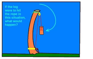

Then, I'd say it was coincidence that the log hit the rope in a weird/forceful way. Was the spar perfectly straight? Or, did it have a bend in it? I'm wondering if it had a bend it, could the rope and spar could create a bow & arrow like situation? (See Picture).
Jamin there was two limbs still left on the piece that was coming down. The limbs were 2-3 inches in diameter and about 10ft roughly. This is nothing exact. So when it came over like in Jamins picture the limbs smacked the rope and as in the picture there was a bend to the tree.
