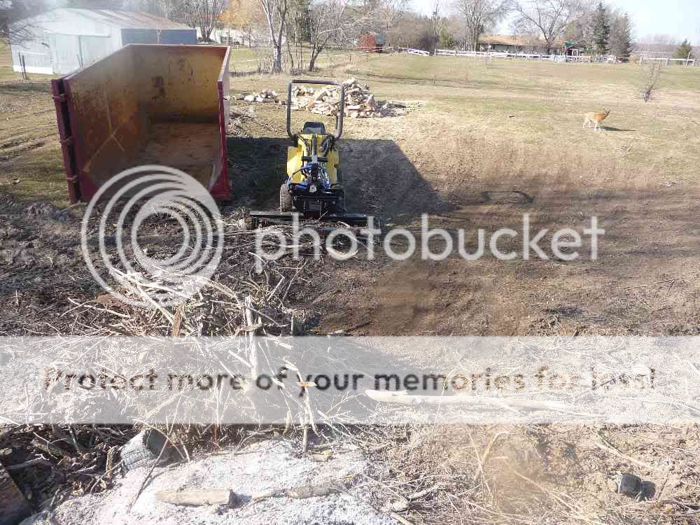

I wonder how those tracks would do on wet grass.

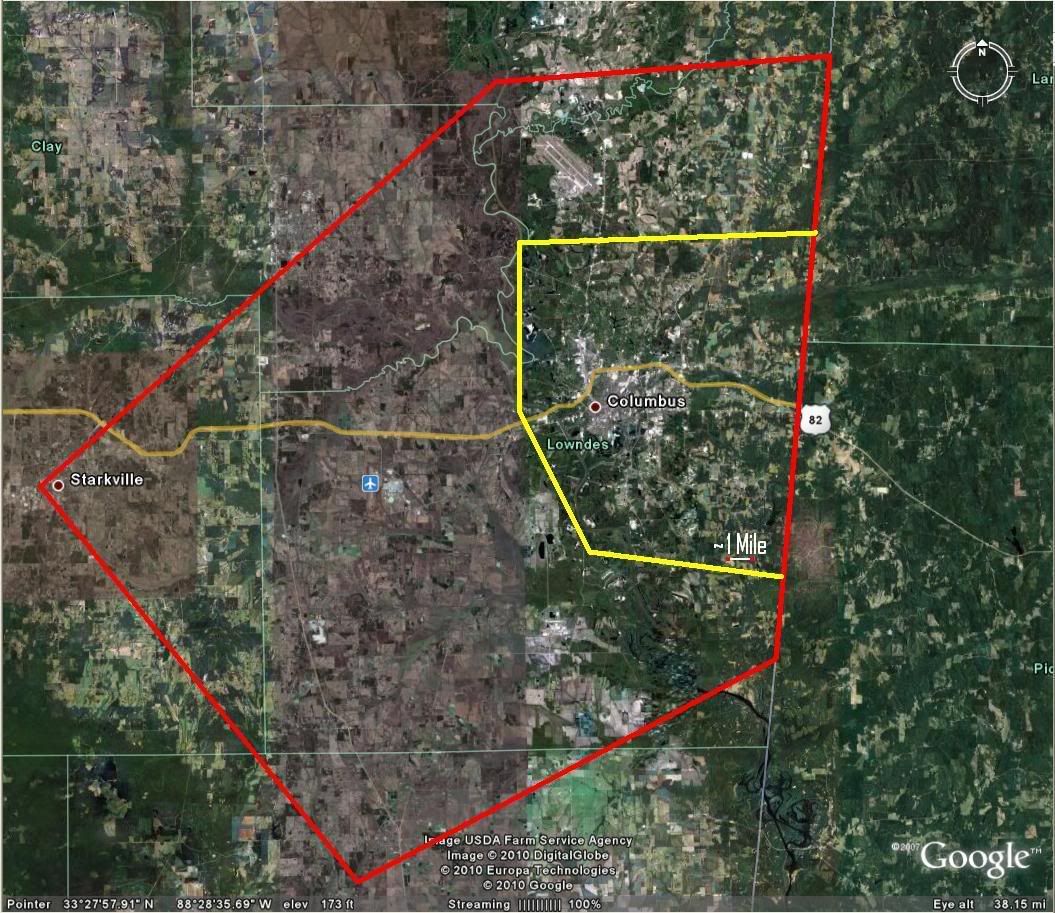

ETA Totally unrelated, but that picture made me think and grab a picture of my usual work area. The red marks the area I do ~90% of my work, probably ~75% is done in the yellow box.
http://img.photobucket.com/albums/v639/10mmsheepdog/Trees/WorkArea.jpg
