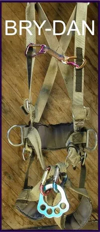

Bry-Dan made by Weaver and sold through Sierra Moreno Mercantile Co. It may not be the sadlle for some climbers but it is the right one for great many good climbers. It will last longer then almost any saddle on the market. If you need details shout out.
