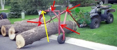

Jim is the one who turned a lot of us on to using quads.
This log arch that Jim made worked great!

AWESOME fabbing there Jim! That is so sweet!
[/ QUOTE ]Thanks , We built that in the pre-mini skid days. We made it to be collapseble for easy transport.Dave from tnt made one also to haul the 4 wheeler.I gave mine to Tom D when I bought my first dingo,I think daves' is sitting in his bone yard.Thanks for the pic Tom.
