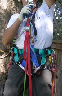

The Treeflex is built around SRT ascent. This made the chest ascender attachment very easy and comfy. After rigging up the rest of the Tree Frog with the Unicender I was ready to tension the rope and get to work. Going into the tree was so comfortable. The setup I made for the BFII was OK but this was way better. After reaching my TIP I got off the chest ascender and slacked off the shoulder strap but left the chest ascender in place. The shoulder strap would act as a suspender and be ready to go if I had to ascend later. Sitting back in the harness for the first time is a true test. Will it be a crotch biter? Will I feel awkward and unbalanced? Nope and nope! The leg risers bring the load out of the groin and the back pad feels like someone is holding me up. Very nice.

Tom, in the second picture the belt of the TF seems to be in just about the same spot as any other saddle.
Are you wearing it correctly ? I assumed that the belt would sit lower on your hip bones?
Also how is the buckle system on your waist? Does it stay cinched or does it creep open after working in it for a bit?

After climbing a couple of times I've lowered the waist belt. It feels different for sure...but good.
I would really like to have someone who could take better pictures. It almost takes another climber to have an eye for what I want to show. Tomorrow I'm helping Peter Jenkins with a climb and I should be able to have one of the other facilitators take some pics.
The chest ascender is held up with a homemade sling. Just some flat nylon webbing and a friction buckle. When I get it sized right I'm going to add some fleece pads at my shoulder/neck. Even with just the webbing the straps aren't too bad.
