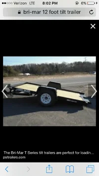

Not to derail thread but I have same thoughts on trailers as flying squirrel I do have an equipment trailer for min excavator and skidsteer and use dump for mini loader and stump grinder. Did stumps all day and had to unload Ramps and etc. Been thinking of a small 12' tilt easy on and off and small to tow behind bucket. So ordered the bri mar 12' tilt a little pricey but a lot easier to load and unload throughout the day.
