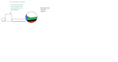

You might be able to just do all from one side with one saw, if you face is smaller. I attached a diagram of how I would do it.
First the small facecut.
Next cut down on the near side to allow the roll-in for the bore cut, and establish hinge, then cut upward to the backstrap (not in pic).
Lastly, trip the backstrap from the top downward, maybe by handsaw to allow you to exit the immediate area easier, if needed.
