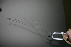

I am starting to explore splicing and saw a great photo of this coant hanger ( I think) tool witn a carabiner handle. I am not sure if it is a new post or if I was digging in the past. I was hoping someone might know a way to this or other photos like it, I am not sure if this is the forum for this but it seemed to make sense... thanks so much!

If someone had a photo they could post of a functional coat hanger splicing wand I'd greatly appriciate viewing it. I normally use my samson fids to splice hollow braids and such for friction cords, though I'm new in the game and haven't built up the guff to attempt a 16 strand splice yet,nor do I have the right tool... but if I could make one...

Here's the one I use, my brother made it out of piano wire. There's a thicker wire and a thin one depending on what kind of rope is being worked.
I also have a longer one I use for 16 strand, same principle.

I use piano wire too, somewhere in the neighborhood of .050".
This is the picture I think you're talking about...
It came from a post by Rich H in <u>this</u> thread.
it works like a snare, just trap a little bit of rope in the end of the loop. when you pull it through, the cover of the rope keeps the end tight on the snare..
