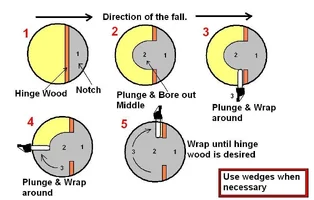

By the photo it looks like there was about 4" left in the center of the log to be cut. Am I right? And if I do the math right... The cut was being made into the wood at about 44" diameter. If you had a 20" bar, I believe you could have still cut a 60" diameter tree down.
Here is how. See attachment.

moral of the story is after the tree is cut up to the hinge i cant see any way to trip the center except with a longer bar
On the back side of the tree, bore a pocket that is big enough to receive your powerhead. That would allow you to reach the center 'post'. I've done this many times for stump cuts. Also good for setting a jack.
Course, what Jamin showed is preferable, although it sounds like you know that method, but you were in a hurry and didn't anticipate needing to bore into the face.
Nice diagram Jamin.
BTW. I just updated the illustration to show clearer what the hing wood looks like. I have a 54" log here at my home I put down with a 20" bar. I'll have to snap a photo of it tomorrow.
thanks for the input guys. the problem didn't become apparent to me until i had a fair size pole rockin on what i thought should have been much less hinge than it needed to go on over. the pic shows that i sawed the left side off completely. the truck had the tree and when i sawed the left side of the hinge off it 'bounced' on the bar but didn't sit back, i knew what i had done then but i didn't have any idea how to fix it. tree cut up, hell its cut off on one side, rockin on a center post, aint the time to be trying to cut the center out. jammin's illustration speaks volumes for how u cant reach the center anywhere but from the face or like mahk said from the back with a 'jack like scenario'type thing cut.i got lucky on this one but 4" more width and i got a problem that only more bar can solve. its 20 miles to a 64 and 36" bar thats paid for anyway. i realized my mistake a little late and that was my purpose for the post,"if u aint swingin over half the width of the back cut, take just a minute and think about it". thanks again only thing better than a strong mind is 2

TGC111, A center post can stall the tree alright, and happens now and then. You found that out.
Your hingewood shows some conflict(offset) between the right and left side. That can stall a tree too, drastically. And cutting one whole side off ,the left, is a rather risky technique.
Using a loggers tape or gunning sticks to mark the corners for the hinge can help a lot in the prevention of both errors.
Just some advice.

Jamin - Does that technique that you showed have a name? I've never seen it done before. It looks from the illustration that it would take a lot of skill and experience to do properly. A poor angle or position of your plunge cut (picture 3, step 3) could take out too much of your hinge wood and make for a bad day, right?
"It looks from the illustration that it would take a lot of skill and experience to do properly."
Too true Barnhouse. Although Jamin's illustration is spot on and is now saved in my hard drive (thanx, J), this technique is NOT for the newbie. It should be practiced in a 'controlled' situation, whatever that is.
Evaluate each situation very carefully and if you find yourself wanting to work beyond your skill level, STOP. Get someone with more experience or get a longer bar.

I don't know if it has a name or not.
I'm sure Jerry would know. I checked out a logging book at my local library in 2002 and found the technique. Because I was too poor to buy a large saw at the time, and some of my tree removals 3 times the size of my bar, I used this technique on those.

advice well taken sir when i tried to reach a little deeper which lead to the center of the face being to 'inverted, just that inverted' thats tells the real story. i should have known right then i can't get the back, at least conventionally. but instead i progressed to the boring from the front which got that part of the job done but finishing the back cut was still a issue that was coming up soon. it worked out ok and just the conversation from one picture that we've all had is pretty strong. my education for the most part, didnt come anything like this but it's great. jammin's got the illustrations to back what he's feelin and thats even better. thanks to all
Nice job with the attachment. What program were you using to make it?
It is the way european fallers cut trees. We are not in the habit of using long bars, and therefore rely on plungecutting.
I spend most of my winter falling mature beechtrees, 3-4 feet DBH and never use a bar longer than 24".
As for the ( picture 3, step 3)plungecut. NEVER plunge in right behind the "hinge to be". Always plunge a little behind it and then once the saw is all the way in, bring it forward, while keeping it parrallel with the facecut.
Otherwise a little carelessnes while cutting, can ruin the day.
Like I tell my apprentices, once you've cut too much hingewood away, it's kind of hard to replace.
Absolutely right Stig. I second that. Husqvarna has a great illustration for this very method. Felling Techniques (Scroll down about 80% to see the method) And they even include felling a tree which DBH is twice as long as the length of the bar.
