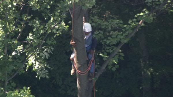

Looks like he's on Velocity in the pic.
Holly, you don't know anymore details than anybody else and you're making wild, ignorant assumptions and cracking on a tree guy because he was hurt on the job... WTF?
You've got better eyesight than me I guess Blinky. But if he was indeed tied in on a bodyline, then he must've been hurt really bad not to be able to work his way down without all the bucket assistance.

Mark C, I thought I heard you're a part of a high angle rescue team? Could you chime in on any of this? Maybe you know more about why a climbing aerial rescue wasn't used? Or does high angle not necessarily mean on rope? The tree looks sound in the photo but it's tough to tell.

I know said company, did you not see me write this before? Trust me the guy should never have been in the tree all he knows is gaff and 2 lanyards, the line at his waste is in a gibbs and runs to the ground just used as a second long lanyard and to pull ropes and saw up.

the initial call for the accident was that the climber was impaled. he was not. the cut end of the limb (he is sitting in the crotch of whats left of the limb he cut) swung back and struck him in the chest. fortunately the cut was smooth. based on the little that the climber was talking (i can speak spanish) it was determined that he was stable enough to wait while the ladder trucks were put in place. the technical rescue crew was consulted throughout the operation. if at any point the climbers condition worsened other steps would have been taken. the tree is a tulip poplar and did appear sound.
when i got there the climber had on his spikes and was tied in with an adjustable flip line and was later attached to the lowering line from the limb that struck him after the limb was lowered. the lowering line can be seen in the pic in or under his right hand.
there were several rope rescue trained climbers there and the idea of climbing to him for the rescue was considered.
they were members of mercer county task force 801 which consists of several technical rescue units. if they felt that it was necessary to climb to him it would have been done.
i don't think he would have done well descending on his own - i think the final outcome was 3 or 4 cracked ribs. the etire operation from my arrival to last fire truck pulling out was 2 1/2 - 3 hrs.
