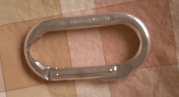

Okay, I've been working at a outdoor equipment store (climbing, camping, etc www.adventure16.com). A guy comes in the other day, asks if we have any more of these 'biners, and shows it to me. I give the "gadzooks" face and ask what happened. He described to me it great detail (upon hearing that I also do tree work) the following story.... (and I'm paraphrasing from memory here)
"Okay, So I cut all the branches out of the tree, only the trunk is left. I had a sling around the trunk and the chunk rope (I guess that's what he called the lowering line) goes up through this clip and around the piece I was lowering. It's about as tall as me, and this big around (he gesstures a piece big enough that you can't quite get your arms around it). I yell at the guy, make sure he's ready, then cut her free. There wasn't enough wraps around the tree, because the peice came down fast, and stopped JUST before hitting the sidewalk. I took the sling off the trunk, climbed down about 5 feet, and got ready to do it again. I got the sling on, had my pie cut, tied the rope on and made most of the through cut. I stopped for a second, made sure he had the rope, and this is when I noticed what had happened!"
At that point, he stopped, called for another 'biner (clip) and used them both for the rest of the tree.
He wouldn't give his name or his company. I brought him to the office, got online, and showed him the ISC rigging block, and pointed out that it almost costs LESS than the 'biners he was buying. He insisted he knew what he was doing and this is how his boss showed him and the boss had been doing it this way for ages. He didn't listen to my suggestions much, and walked away with 26 new 'biners.
Scary.

Here's a better pic, I just scanned the biner.
At the top of the biner (the good side) there is 11mm of aluminum. At the burned side, 5mm.

i think steel will take 4x more heat generally, but aluminum dissipates it from the immediate area faster; is like a jealous metal that wants quickly what it's partner has(closer to copper; used in cooking for even heat). Not sure what ranges that steel is preferred to the aluminum for this heat, might depend on the amount of aluminum in device?
Titanium is da chit; even higher melting than steel, strong as steel, 1/4 steel weight and conducts heat like aluminum. The 'cold' side/ opposite heat in aluminum and titanium gear will burn ya much, much faster than steel!

There are some ironies here, IMHO. (And ditto to the remark rockclimbing stupidities.)
Firstly, I think "burned" is less apropos than "abraded" re the 'biner. It's fairly well
understood in the climbing (and I should hope in caving & SAR) community that lowering
and general usage will wear down aluminum 'biners, over time. Dropping big loads such
as tree chunks requires less time to go over! There is considerable friction between
nylon/polyester and aluminum, w/some less for anodized aluminum; though HMPE (Spectra, e.g.)
has a much lower melting point, it might fare better (ironicly) because of its much lower
coefficient of friction w/steel: I recall one Marlow (I think) test of sheaths of HMPE vs. polyester
where after some 9,000(?) repetitions of pretty heavily (50% tensile?) rope back'n'forth
over a pin a polyester rope broke; yet after 30k rep.s a Spectra one was not much worse
for wear, the test aborted(!!).
(It's of interest here to note one case of a climber testing the back'n'forth abrasion
of (old) climbing rope across a nylon (1" tubular) sling: the rope wore through!
And the sling was damaged too, but intact at rope failure. --not what you'd think!)
So, Nick rec's as conventional wisdom the arborist pulley, which surely greatly reduces friction
at the bend point. But how and WHAT does this help?
--no more wearing out of 'biners
--less wear on bull rope
--MORE load on:
1) rope belay
2) pulley anchor & support
Rule of thumb for load distribution over a 'biner is 8-to-5, the falling object side of course
having the big half.
Were that rope tied off to the 'biner, one would have the load of the accelerated object
(less some slight shock absorption from the low-elongation rope)
taken by the anchor.
But with a low-friction pulley, one has that force multiplied nearly 2-to-1, but less
whatever belay slippage is given to absorb the shock.
