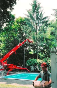

i normally research things well before i buy, i'm just trying to get more info so i can put in a decent LOW bid cause i don't have enough time to fully research. I don't NEED it and I really would like to buy one of those teupen spider lifts (picture here in case you don't know them).
