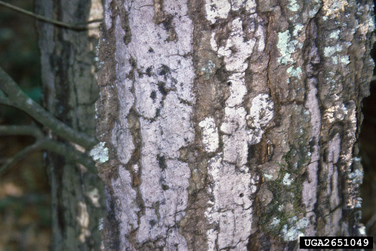

So back on track... I looked at the link you provided KT, and I've seen this many times around here on Quercus laurifolia. Most that I've seen were near-dead or already-dead and we removed them. The wood and bark was harder than normal, almost like concrete in spots. It was even tough to get the spikes in when climbing on occasion. Normally black wasn't the color I noticed but more light gray. Like this:
But when looking closer at the photo I can see the black fungi in there.
The photos from the OP certainly look more like Xylaria than Phytophthora now that I've given a better look. Especially how dry they are and how the bark is sloughing off.
