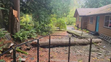

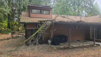

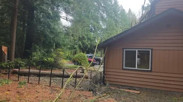

She assessed, prepped, cleared the roof and blew it off, solo, in 3-3.5 hours in the rain. Hauling tomorrow. Flat ground. Arbor Trolley and/ or hand truck for the wood. She doesn't care for unloading/ loading/ securing the Mini-loader, which would require 2 trips. She will probably make it in one load with a trailer. Punky, so not heavy.
Missed the context. So is the question on a price of debris hauling or insurance compensation for her work?
Good thing I’m not an adjuster, as a dead hemlock like that seems to be a plainly obvious hazard to the layperson.
If paying out of pocket for debris hauling I’d probably just do a flat $1000, and depending on how my back is feeling bring the mini or not.
Insurance compensation for the removal and $500 of debris removal.
How is one to determine what exhausts a $500 budget???
Show up/set up time, hourly rate and disposal costs... Prob leave only 1-2 hours of loading time at a reasonable rate. If I liked the client (which I already do by her own gumption) I'd prob do it for a flat $500
ahh I get it now, employee doing the work and not the homeowner clearing their own house and getting comped by insurance...
Insurance typically pays for the material on the roof as part of the shabang. Honestly I price it as a unit, and then do extra work as needed. I've successfully removed a leyland cypress trunk on the ground that uprooted and slid off the metal roof on the log cabin. Used the mini of course but I had to cut my way into through the debris to get the remainder limbs on the roof.
The adjuster was there so I was able to have a conversation. Seemed silly to pick up trunk and limbs to pile on the side when the chipper was closer. At first he grumbled by then came to reason that the chipper was the shorter route.
Wood stayed on site, but had to process and move to a convent location to clear a safe work area for the roofers and other contractors to fix the damage. Sometimes debris handling is just part of the job, like in your photo, are you suppose to step over the log on the ground to get the material that was cleared from the house?
