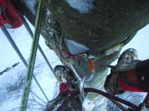

Better backup system when blocking down a spar
When we block Down a spar, we use this system, where the climbing line is tied around the stem as a backup for the lanyard - as most climbers, I know, use.
However, it is not possible to descend on the system, in case of an accident.
Have tried the method, where you choke the climbing line on the stem, and add a figure 8 behind the prusik. It is safe, but extremely slow and clumpsy, when you have to move Down the stem.
Any good systems out there? :-)
