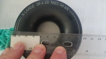

Just to clear up something, 38x28 on the Beast X-Rigging Ring is simply the numbers for the big hole in the middle 38mm hole and 28mm for the grove trench.
Outside dimensions of current Beast ring made in the USA is bigger than the original that I had antal making in Italy.
Outside size of current beast is almost 100mm tall, around 98mm. Outside diameter.

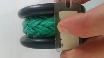

Width is around 48mm wide.
The walls are a massive 11-12mm thick.
I'll take some pictures with a ruler and post next.
I'm not trying to hijack the bendright thread, but saw some mistakes on the XRR beast size discussion.
the fish eye lens of the phone taking pictures pulls in the view and makes it look 1 to 2 mm smaller due to distortion. Really need a verneer (sp) caliper to measure exactly.

Ah yes, sorry. Brocky probably thought the selden ring was bigger than the Beast due to the poor description in treestuff. Where they say it is " 38mm ring size, 28mm sling groove", which is wrong. The hole is 38mm. The ring is around 98mm. In the selden picture, the XRR shown is the original medium sized XRR. The three sizes were, medium, large and X-Large (Beast). Shown was the medium. The new XRRs are way fatter and way taller BTW. Just same hole size and rope groove.
