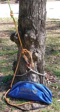

The anchor system for my SRT line was made by Nick. 3/8" coated Yalex with nylon eyes in both ends. There is enough to go around a 6' diameter tree. The prusik is made with a tight eye for the biner and a longer eye so that I can make three wraps.
My preferance is to use a rack for the belay. There is lots of friction and the rope tails up so that the belayer naturally adds more friction by pulling the bars together.
If a figure eight is used it should be a large rescue eight with ears and a double wrap should be used. Figure eights don't develop a lot of friction. In most setups a Munter hitch develops more friction than a figure eight.
Lately I've been working in tall trees so I've taken to tieing two ropes together so that I can be lowered in case of emergency.
