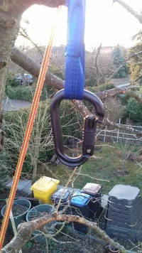

So this just happened unintentionally on a climb. I was using it to lower something and it wasn't for life support. I tried it afterwards intentionally and have been able to replicate this opening it with one hand. Does anyone have experience with ths carabiner? Does yours do that too?

So what is happening here is that I am able to use its 4 way locking mechanism while the carabiner is open. The way the Rondo 4 works is that it's a triple action carabiner, but you can push the barrel up farther when unlocked (shouldn't be with an open gate though) then twist it another 90° to lock it in a way that requires 4 motions to open. However, this can be done with an open gate here, essentially locking it open.
@evo Bought it about a week ago, has two climbs on it, minimal use, once as a backup for an alpine butterfly stopper and then that light lowering duty when this happened.
