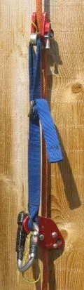

This is one of my SRT ascender setups. The biner attaches to the front d on my harness. One of my hands goes on the rope just below the microcender and the other hand rests on adjusting buckle on the blue webbing. This configuration puts my hands in almost the same position as any double handled ascenders.

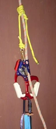

Bow shackle for Butterfly saddle works well. Here it is used on a doubled climbing line, but the tether could just as easily be a single leg for SRT.
