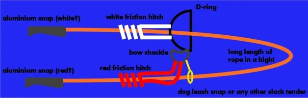

Hillbilly made a nice diagram of the DEDA lanyard. Try doing an archive search on TreeBuzz. If you can't find it here, go over to Arboristsite and search. After getting the Adjuster, I substituted them for the hitches that I used to use.
Tom
hillbilly at your service
Here is the illustration of the DEDA with hitches.
How is the Adjusters working out Tom, have you
gotten around the spacing problem, keeping them in
place on the square Maillon ?
