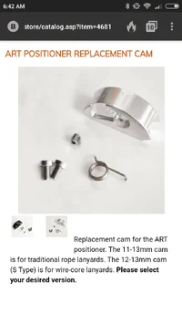

I had an ART Positioner for a brief time and didn't like the idea of replacing cams, so sold it to a friend who really liked it... unfortunetly, it didn't have the cam for 5/8" lanyards, so I never got to try it on my homebrew wirecore fliplines. Really would have liked to try it, because I seriously doubt if they would cause any wear to the cams.

Maybe I'll look for a used ART Positioner and make one with it. I believe they still make a cam for use with a 5/8" diameter line, don't they?

I was thinking of maybe trying something more drastic on the cam of the AP2 like grinding grooves into it, or even trying to get some additional metal welded onto it here and there... Though I'm most definitely no metal working expert (I'd ask someone else to weld if I was going that way). What does anyone think?
As far as I'm aware - there is no AP2 cam for 5/8" lanyards.

I thought there was a 5/8ths version at one point as well..
I don't think it would be hard to accomplish with a steady hand & the correct dremel attatchment.. maybe even a small 16mn flap wheel.. i think that would give the most uniform removal.
