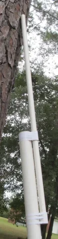

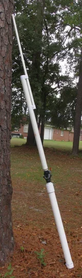

It was two feet shorter than the Big Shot. That was convenient for carrying it around and storing it, but not so good for aiming. Since I have to use a ramrod for loading the throw bag, I added two short pieces of slightly larger PVC pipe on the barrel to hold the ramrod. I had to do a little lathe work to get the inside diameter just right, and I left a little step, so the extension always fits in the same position. The ramrod stays in the barrel when the cannon isn't being used.
With the extension in place the aiming is just as accurate as with the Big Shot, maybe even better. I've used it several times for shots over 75-feet and hit my mark in one shot each time. What an easy fix to what had been a vexing problem.
I'm already thinking about adding a piece of pipe to the Big Shot so they both look the same when aiming.
On the sling-shot the travel path of the bag isn't dead-on-axis of the pole/tube due to the various methods of hold/trigger release vs the offset of the forks. On my setup I'm fairly axial, but I've got some offset/angle which I'm sure adds up to aim error at distance. But I bet having the extended tube tip to sight by eye would improve aiming.
Correct me, you don't look through the extension tube, you just sight along the outside of it?
Do you shoulder fire or butt-end-on-the-ground fire?
I kneel when using either launcher, put the butt on the ground, and brace it against my knee. It's really easy to aim with the arrow release trigger or the blow gun trigger on my launchers. Both require no significant movement or effort, and I can take my time while aiming. The blow gun takes the place of the solenoid on the modified lawn sprinkler valve. I'd be shooting all over the place without the triggers.

I line the extension up with my desired spot in the tree (left-right position) and then judge how much to lean the cannon forward to get the height I want. If the line ends up above the desired spot, I can usually work it down with another weight. If it's off left-right, I can put a stick on the line and flip it over the limb to move the line where I want. Most times it's just quicker and easier to make another shot.
I made three shots this morning to get a good TIP eighty feet up. The first two bounced off the limb I wanted. The third was several feet out, but I was able to stick-flip it back to the trunk and then use the extra weight to get a straight drop from both sides of the limb. I pulled up a climbing line to make sure there was nothing that would stop it from going over the crotch. Then I left a bookmark line in the tree for when I come back to make the climb. With all the preliminary stuff done, I can concentrate on climbing when I come back.
