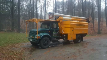

I have this truck for sale! I just needed it to finish a large contracted job. We have been using it all winter. I need to get rid of it only because I can not have more than 5 trucks in our yard and I have to make room for some new stuff coming in. Let me know if your interested. I am pretty open to offers at this point. Its been a supper reliable truck. Your not going to win any races. But it starts everyday and gets to the job...guaranteed.
7.3 Liter Diesel
58 feet boom
low miles
Tires are good
boom is very smooth
Plenty of space for tools
Boxes are water tight
Standard with a split rear end.
I'm sure there are other good things I did not mention. If you think of something just ask.
