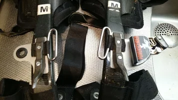

Get a Powerscender from Mike on this forum (or a spikescender from Kiwi)
You don't need to spike the whole tree, just Climb the rope. Add a knee ascender like the HAAS and you're all set. :)
It has to fit your spikes of course.....

Wear the spikes up first climb but I attach the SAKA to one gaff and do the one leg with the other leg on top assisting thing.

But 9.5 times outta ten, its foot ascender under my spikes, SRT system, and rope walk up. I used to think the spikes would be dangerously close to your feet, but its not as bad as one would imagine.
