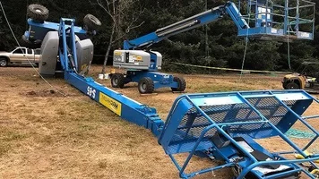

There’s a pic of the telescoping boom lift, a rented Genie S-85.
They climbed off the platform into a tree and stayed tied to the lift basket.
Do you think they had counterweight setup correctly to ascend and work from the platform then things went wrong once the extended boom platform lost the 2 men’s body weight when they climbed out?
I honestly don’t know but it could explain why it tilted and why they didn’t have time to react to the tilt alarm. Just a theory, probably never know for sure unless we learn the investigation findings.
The boom in the pic isn’t extended very much.

I spent about 3 years using a 65' tele lift without the articulating stinger on the top. It was a very stable machine in my experience
It looks like the lift went over 'backwards'. The counter weight is on the ground...the lift isn't extended in an attention-getting angle...the boom isn't extended only rotated.
These lifts are meant to be driven with the boom extended. When I first started running mine I spent time in a flat, empty parking lot doing some test drives. The controls would over-ride driving sometimes. In the position shown in the pic I don't ever recall being one bit wobbly.
Big question...why did if go over 'backwards'? the ground looks level and not muddy.
Let's hope that the results of the investigation are made public.
From memory reading about the events there was an increase in wind and they were on an incline. Vaguely remember reading there was a wind gust.
my thinking, for what it’s worth, is that the lift was positioned sideways on the slope, where the wheel base is narrower than it is long, and the counterweight was on the downhill side. That potentially makes the counterweight “heavier“ then it would be if it was sitting on flat ground. Perhaps when they left the basket, the loss of their weight, so far out on the boom, was enough to underweight the basket sufficiently to cause the lift to tip over backwards. Our crane service had something similar happened years ago, at his shop - an operator picked up the boom and swung sideways without the outriggers down, and the crane tipped over onto the counterweight side.

Exactly what kinda bucket/lift are we talkin, articulating, scissored, tele?
Jemco
That kinda lift's weakest point off to either side, which is the configuration the pic shows it hit the ground in.
Pretty sure it's meant to be used off the front, not the side.....
Jemco
The one I ran could be operated to the side. In fcat, ta sixty five feet extension I could put the basket about five feet below level...and drive too. There were all sorts of controls that wouldn't allow me to go into setups that a were wrong.
It was amazing where I could drive with the boom up and out. Especially with no extension like in the pic.
But...like what's been suggested...two climbers getting out of the platform would have changed the loads and might have caused a springboard.
True no doubt, on level ground, bu not on an incline.
You'll never see them in the rental yards retracted or extended anywhere but straight ahead in its most stable and wind resistant configuration.
