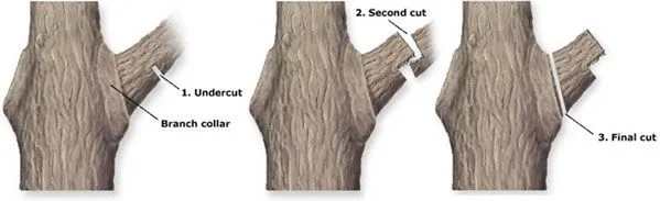

That undercut, top cut farther out and final outside the collar cut image is in almost every publication. And....it's dangerous. Fine on backyard light fruit tree pruning but it turns into a saw snatcher on bigger cuts. How about we stop using this bad advice as our most primary education? See attachment above.

One of my not so pet peeves... that training is 20 years out of date and still the biggest cause of saw snatch in the industry. I actually started doing a video on it. Its on the back burner for now though..
I made a recommendation on the last ansi pruning standard about the 3 cut diagram thy use... its ridiculous.. these guys are supposed to be industry leaders, and they keep feeding us such garbage...
As far as I know the latest teachings on "how to" perform a snap cut is that you line the top cut with the bottom cut just for the reason you both are stating. I've been using this method for over a year. Throw away your old books and buy some new. lol
I know what is my source? Probably 'Arborist News'.
I'll have to check when I get back home, but I'm pretty sure that the newest "Green" edition of the ISA Certified Arborist's Study Guide, instructs you to line up the top and bottom cuts, specifically to avoid getting your saw grabbed by the released branch.
The green edition of the study guide has been out for several years now.
pg 119..
diagram of the 3 cut method, with the second out beyond the first.
I just took the CA exam on Saturday... made a comment about the fact that they are still suing this diagram.. Its 20 years out of date.
I absolutely love this book. and would recommend it as the number one single book for anyone that wants to be a pro arb.. That said I strongly disagree with most of what is on that page and that little bit of time they devote to pruning is a real shame. and 10 years behind the times...
The philosophy of best way to prune is to make thinning cuts at the parent trunk is a huge misconception, still held by the vast majority of pro arbs, around here at least.
No reason not to make the top cut directly on top or even slightly behind the undercut...
bigger cuts should get a narrow notch undercut, meaning removal cuts, NOT pruning cuts, in general...
Why limit yourself. It really depends on what you want the branch to do. I'll align the upper and lower, mismatch with the top behind the bottom, vice versa, notch, etc… The primary point is to not make your detaching cuts the final ones. It is better to leave a stub to be severed with the final cut.
I with TH here. I think you are all reading too much into it. The diagram is about making a final cut, not removing and or reducing a branch, stem, lead or limb. That is another skill set. Possibly used in conjunction with a final cut.

The fact that well informed and seasoned professionals are not in complete agreement on what these old or new documents are intending to convey tells me that more clarity should be included.
Explain why. We know why, and I'm not pretending to instruct people who know this better than me anyway, but just to complete my thoughts....
It should be clarified that the sequence is intended for smaller pruning cuts only, and why ( preventing tear out) and is NOT appropriate for limb removal during takedowns. And say why (worker safety/saw grab). Show the better way, which is top cut to inside.
It's also not appropriate for larger pruning cuts for the same reason. Show the alternatives for this scenario: matching cuts or making a face cut first. Why would you not just use the method you use for removals? I think it's because of the greater chance that the piece will tear out.

Why does the ANSI A 300 pruning guideline still use the three cut diagram, and refer to the appendix to explain the cut, and even then give only a weak and vague explanation, taking all of page 10 to write two sentences that could have easily been included with the diagram.
why does the cert arb study guide pg 121 say that the three cut is used for removing large or heavy limbs... (although to their credit they do make a quick statement in parentheses that when using a chainsaw the top cut should be directly above the undercut)...
