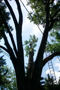

We were sent to this job to remove a 24" limb from an Eastern cottonwood that was structurally compromised. Very tall tree with utility lines on 1 side and an evergreen hedge on the other. Everything was gonna have to be driftlined. Fortunately for us, we brought the GRCS, which came in handy. It took a while to set up the rigging. First pic shows the limb being removed before any lowering.

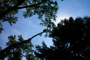

Second pic shows the limb from a different angle. We couldn't lower anything straight beneath me cause of the neighbors utility lines. The spruce and pine can be seen on the border between yards.

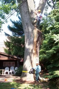

This pic shows the GRCS strapped to the trunk and the collar cut (on the right). The man at the GRCS (Beto) is a great GRCS lowering man. The man in the tree (Tom Lentz) is an intern from UWSP. That is the crew, the three of us. Very limited landing zone. You can see the spruce on the right and the utility lines on the left.
