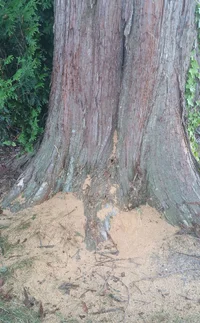

UU Lady Fairhaven Park cedar_ants.webp UU Lady Fairhaven Park cedar canopy_ants.webp UU Lady Fairhaven Park cedar_beetle.webp UU Lady Fairhaven Park cedar_beetle_closer view.webp I noticed two red cedars (coastal Massachusetts) that are hosting a couple of varmints. I know that the trees in question are too close together for starters. They are on the park-style property of a church in Fairhaven, MA so I was hoping to get some advice to pass along to the church about options for them to deal with this...or not if you don't think it's critical.
Larger tree has ants, probably field ants since they aren't as big as 'carpies' that have been building a good sized nest. I took a couple of snaps of the canopy which is looking pretty sad though it could be more because of competing with the smaller tree.

When you mentioned the ants making a nest, I did not realize that there was a hollow. In that case the frass is probably coming from the ants excavation efforts of the hollow and probably wont damage the tree. Even if the ants are carpenter ants, they are more interested in eating fungi growing in the tree and having shelter than they are about eating the wood.
Yeah, there's a small round hole in the trunk that has the ants coming and going like a frat party. I did couple the tree base photo with that with the dead wood in the canopy since I'm not the expert like you are (all of you on this forum). Even if the ants aren't doing serious damage, it doesn't look as healthy as the other tree next to it (even the squirrels agree since they built their nest in the smaller tree's canopy!) I might suggest the church be prepared, nevertheless, to let the 'ant' tree go and give the other cedar more room.
It is very common to find mature Eastern Redcedars that are at least partially hollow and contain carpenter ants. There is still some debate as to whether or not carpenter ants are harmful in any way to live trees. Eastern Redcedars are pretty hardy trees so, I doubt that the tree is going to die any time soon. It would certainly look a lot better with out all that dead wood though.

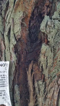

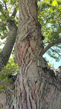

The "highway tree" is a Tilia platyphyllos, one of two. It's definitely one that falls under the state's care. I think it is in worse shape than people realize and enclose some snaps of it that shows the condition. the overhanging branch just barely arcs over the right of way though a large truck could probably whack it if hugging the curb. This roadside park has another large leaf linden next to this one, a sad looking locust tree, a Norway maple or two, and then a really nice Tilia chordata just around the corner from these--it looks pretty fine but could do with a skilled prune before the utility companies come along with murder on their minds.
I'm not an arborist, but my amateur guess is the tagged tree should come down due to the structure looking very off-balance, the large crack, and other bark irregularities not present on the other Tilia platyphyllos.

Tilia platyphyllos_route 6 damage001.webp Tilia platyphyllos_route 6 damage007.webp Tilia platyphyllos_route 6 damage009.webp

Carol, those features say one thing but other features point to the trees' strength. A competent assessment is not Defects + Targets = Removal, even tho that's often done. Carpenter ants are almost expected in trees that old--to cite them as a key factor is nuts.

I am not sure why else the state wants that tree to go IF it's not in grave condition; it's bit chewed up by either gypsy moth (heavy this year) or winter moth (same again). We're paying the price for not having an arborist for a tree warden here, and too many engineers.
