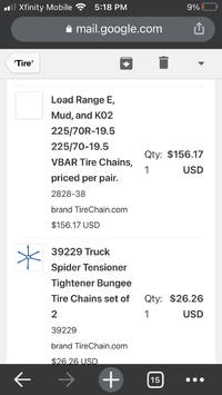

Bought these vbar style which have cam tensioners and we tried them out yesterday with a stuck chipper. Easy on and tensioning, not too expensive and they shipped an hour after I ordered.
