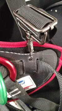

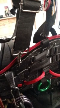

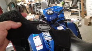

These are cheap suspenders from BucketBoss and are built to be tool belt suspenders that you can find at most big box lumber or farm stores. They cost all of $20 and I didn't add a thing to them to make them work. They come with the small dog leash clips on them (pic).

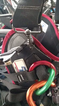

I clipped them into the holes in the treemotion leather in the back (see pic) and I punched two added holes by the D rings (pic) with a leather punch (but I am sure a drill would work fine) for the front attachments.

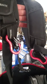

I also use the suspenders for tending my ascenders whether I go SRT or DSRT via the red CT micro biners in pic. The "straps" holding the biners were on there snd it comes with a chest clip to keep the shoulder straps on both shoulders.
