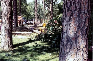

A real bad windstorm had taken out this forked Ponderosa pine in the park.
A view from the other end of the tree.
17 trees fell in the park that nite.
Thats right! I have children! Move the swings Or get rid of all the threats! Maybe at least, a sign to warn for high winds during play! Safety first...trees second
